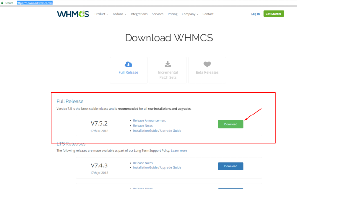

    1. Download the latest stable release from https://download.whmcs.com/
Name:	download whmcs.png
    2. Next, unzip the files and upload the files via FTP or file manager to the respective location on your web server.

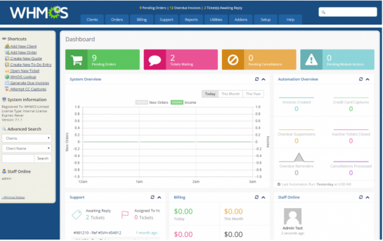

    Now that your website is secure, you can login to your admin panel https://www.yourdomainname.com/whmcs/admin using the username and password created during the installation process.
